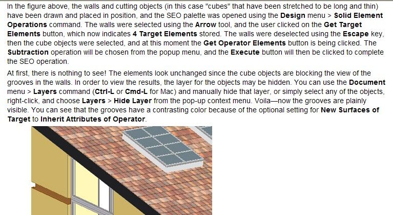

I was trying to cut groves in the wall using seo. i refered the following example from the forum(also show in fig).
http://www.archicadwiki.com/Solid%20Element%20Operations
in the example above we have to cut cubes that have been streched long and thin.
which tool should be used to cut these cubes?

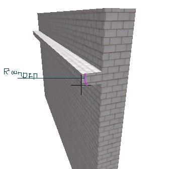

how to make the edge of the cube rounded as shown in fig ?(for creating cornices)
creative wrote:
thanks
it was silly of me i was pasting the cube on the surface of the wall instead into it,giving the depth of groove.
offtopic question
I hope you don't mind me asking in the same thread.
Make that part out of a Complex Profile.
You can make its section any shape.
