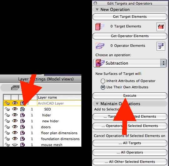

Dwight
You need to execute a subtraction in the SEO.
YOu need to make the layer where the cutting cube element lives "wireframe" to make the cube element invisible.
Dwight Atkinson
thanks
it was silly of me i was pasting the cube on the surface of the wall instead into it,giving the depth of groove.
