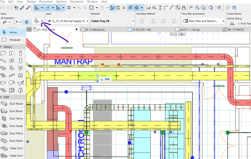

I recently opened an existing working file (AC26) in AC27 and apparently all the MEP elements (ducts, pipes, cablings) has been converted into an object instead of its respective MEP elements. This is a huge problem and I cannot continue routing or modifying those MEP elements because they are in an "object" state.
