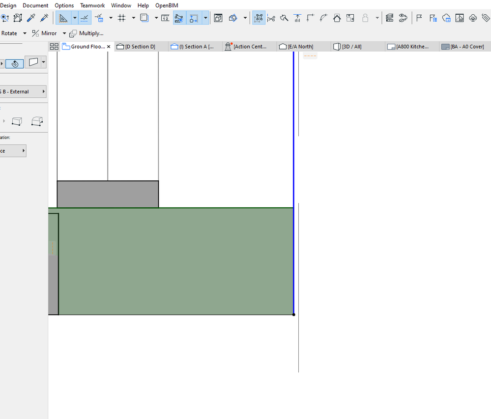

Is there any tool in archicad where I could align the edge of the wall to the grid line (refer to image).

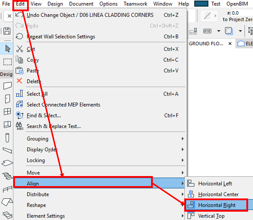

if you select the wall and the grid, you could use the align Horizontal right command.
Edit -> Align -> Horizontal right

yes, by the way it's not a stretch. You don't stretch the wall up to the gridline ...
With "align" in archicad you move the objects to align each other, considering their bounding boxex.

The align command takes in consideration the closest point. The object will not align by rotating based on its bounding box but just move until it reaches the aligning line.
