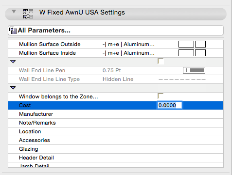

ArchiCAD 18 Update 4020 - OS X Yosemite - Missing Fields
Most text on palettes is screwed up but I have missing/hidden text on all the setting windows.
For example all of the data fields have information but I only can see it if I click on them.

Eduardo Rolon
Another Example

Eduardo,
That is interesting. As far as I know yours is an isolated experience. I use an OS X Yosemite computer as my primary workstation and I have not seen this problem firsthand, nor have I heard from the many users in North America that updated to Yosemite and are using AC18 Update 4020.
I recommend that you:
A. Store and export your Work Environment (if you have customized it or it is not exported from ArchiCAD already)
B. Quit ArchiCAD
C. Set permissions on the /Applications/GRAPHISOFT folder to Read & Write for all names and Apply to Enclosed Items.
D. Run the AC18 installer to Repair ArchiCAD and the subsequently run the ArchiCAD 18 Update 4020 once more.
I hope this helps.

Eduardo Rolon
That didn't do it. There must be a preference that is interfering.
• It happens also on my Laptop
• Suggestions? AC18 Beta?
Even the Icon Text is screwed up.

Eduardo Rolon
Found it!
• I have a font called Aptifier installed that I bought from Linotype
• That font loads before Arial in Font Book
• Disabling that Font fixes the Font issue on both Icon and Object Settings
Looks like at one point AC tried to substitute a Font and chose that one. If I enable it then AC it happens again. So there must be a preference that chooses that font as default somewhere.
