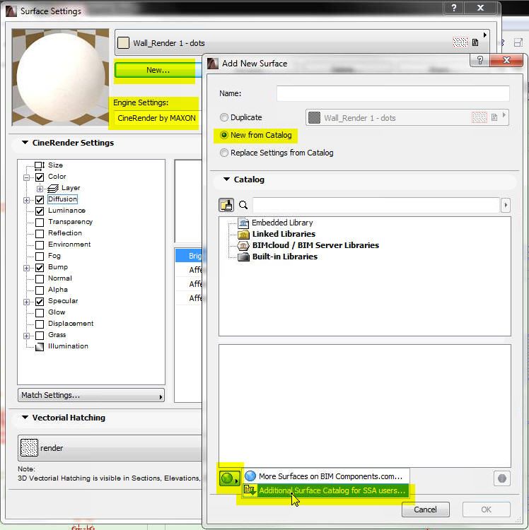

What info? This ?
Aaron - Ummmm.....Re: Surfaces Bundle? Where can I download this? Please share.
Respectfully - Greg
BIM Components.
If you have an SSA then in Archicad when you go into the surface settings dialogue you will see a link to the SSA surface download.
Steve Jepson
Similarly, you if you have the Maxwell plug-in for ArchiCAD you can access Maxwell materials through the same Surface Settings menu.
if you want the really good materials for use with a really good rendering engine.

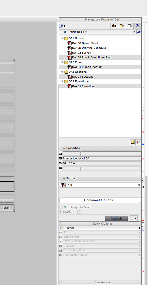

Hey, I'm currently using ArchiCAD 18 4020 build on Apple MAC OS X Yosemite and am currently having problems with publishing any drawings of all types, PDF's and DWG's.
During the process, when I hit the publish button the publisher dialogue box showing the drawings being published does not appear and the publisher button stay's dark grey. After the publishing is finished then ArchiCAD freezes up and cannot to work on the drawings.
Also I forgot to mention I have to force quite ArchiCAD to start to draw or navigate again...
Can anyone provide any light to this issue or even assist in solving this problem?
That would be a great help... Thanks

I did not receive any notification to your message/response to my post. To answer your question, I have recently updated the program to AC18 Build 6000. Hoping that this would solve it, the problem still remains. When I publish either DGW or PDF, the publisher dialogue box does not appear after clicking on the Publish Button and the button turns dark grey as shown in the screen shot attached in the original message. Every time I publish I have to force quite ArchiCAD and restart it...Still baffled with this problem. Have you or anyone else had the same problem...
