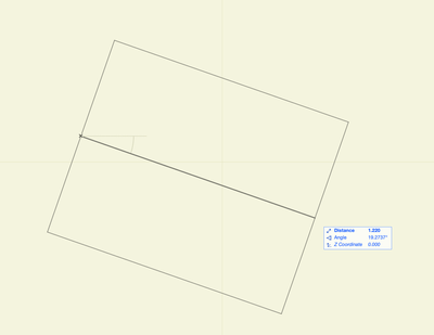

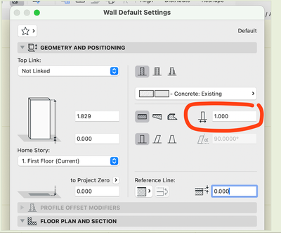

Eduardo Rolon
Based on the screenshot you are using Meters.
Now open the Wall Settings, in the screenshot the 1 means a 1m thick wall
And this is that wall with a length distance of 1.22m shown in the blue tracker box.
