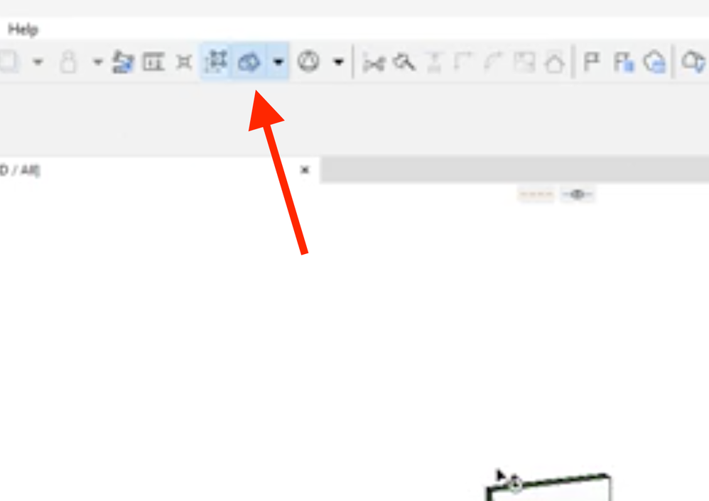

At our studio we had a major problem in Archicad 27. When modelling in 3D, no geometry edits were shown in the 3d window.
New geometry not visible in 3d window, modifications in geometry was not showing, deleted geometry was still shown. The edits in geometry became visible when closing the 3D window and opening it again from plan view. Same for hiding and showing the layer. The reoccuring problem in Archicad 27 is shown in the video below.
Solution:
The solution is to pin and unpin some geometry to a Renovation Filter.
Windows 11, Intel Xeon W-2125 CPU @ 4.00GHz (4 cores 8 threads), NVIDIA Quadro RTX 4000, 64 GB RAM 2666MHz, 1 TB SSD.
Archicad 17-27

Hello @ESK,
It is probably not a bug 😉
You should to unlock 3D Cutting Planes.

Hi Christophe
Thanks for suggesting a solution. Disabling 3D cutting planes didn't make a difference in this case.

ESK
Hi Christophe
My own solution works fine, I just wanted to share the information in the forum. I'm not allowed to send a file containing our company standard template. Thanks for offering your help.
