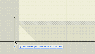

Adding a new wrinkle to the issue.
In some cases you can place the cursor over a spot and type either the distance or the minus sign in order to specify the direction and distance.
Prior the Tahoe update if you were editing Section/Elevation limits the procedure to move it 9" below the referred point was:
  • Select limit
  • Move until checkmark appears over your reference point
  • Type "-"
  • type the distance. In this case .75 for 9 inches
The bug now is that when you type "-" the tracker erases it and inserts 0".
Eduardo Rolón AIA NCARB
AC29 US/INT -> AC08
