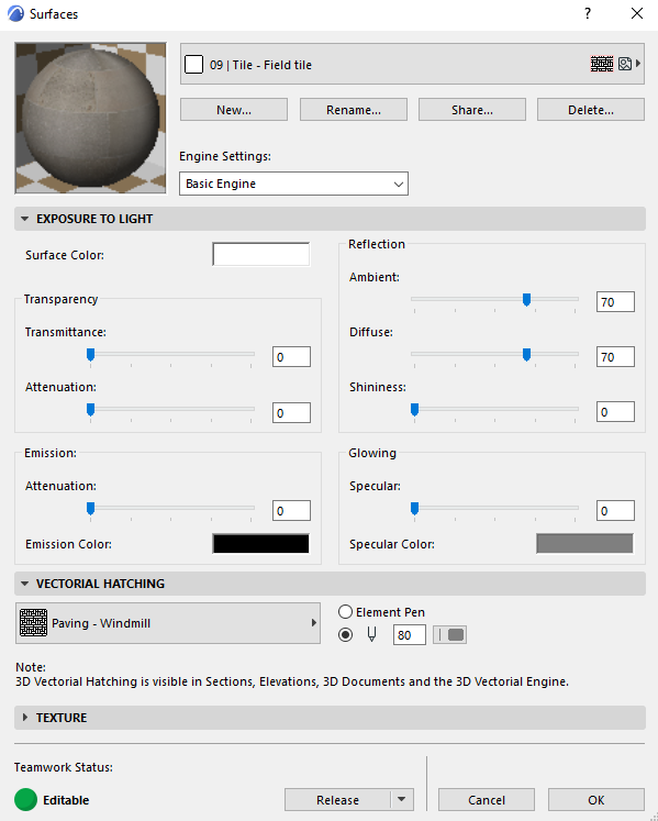

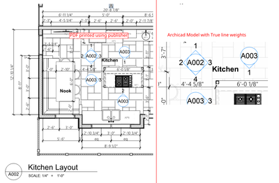

Hello, I am trying to understand what is causing the blurriness in our print outs and PDFs of a tile hatch - see the left hand side of the screenshot below. This seems to be a very intermittent problem, but very annoying and makes the drawings look ugly. Sometimes our hatches print fine, and then sometimes this happens, and I really don't understand what the cause is.
So in this particular instance:
- The tile is modeled as a slab
- The top surface of the slab is overriden with "Field Tile" Surface
- The surface "Field Tile" uses a fill "Paving Windmill"
And then the view is placed on a layout at 1/4"=1'0" scale.
Screenshots attached. Any help is appreciated!!
Core i5-8400 2.80Ghz, 16Gb DDR4, GeForce GTX1060, AC20-23

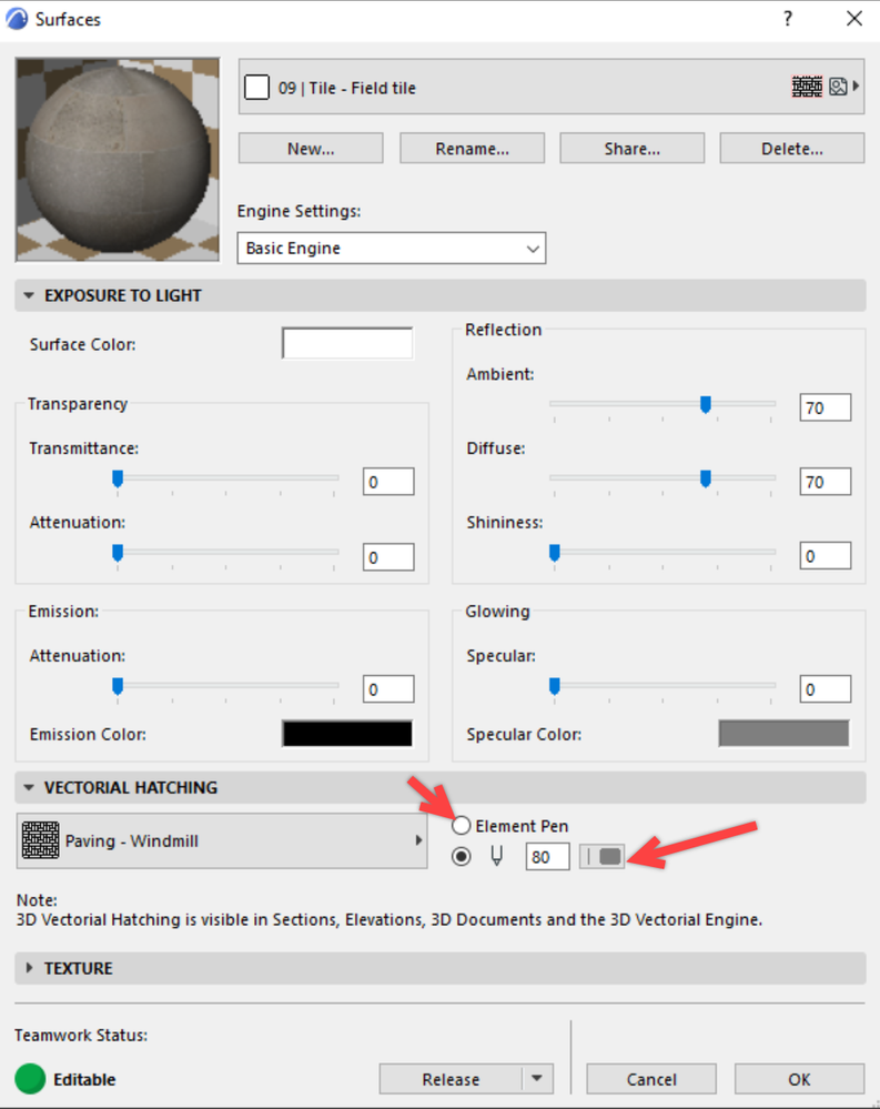

I'm wondering if there is a constant way to reproduce the issue? If you change the type of fill or the pen color, does the issue persist on the same slab?
I saw Steve posted a screenshot before me. What if you select the Element Pen, does it fix the issue?
Looking forward to hearing from you!
