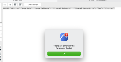

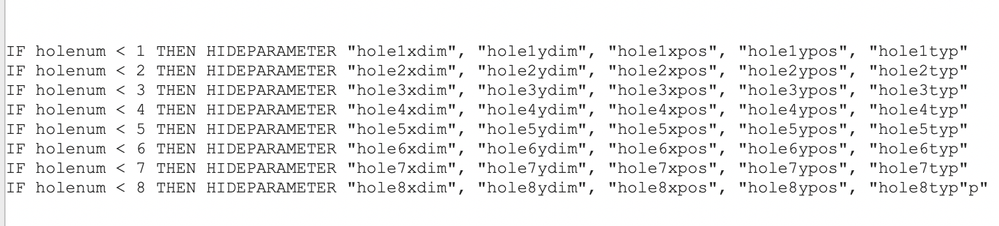

This is happening to me rather often, and drives me crazy with error messages like "missing comma at parameter list" (as in this case) and such, until I realize what is going on. At first I copy-paste the script (select all, copy, paste) onto a text editor, check it there, give up in despair and close the object (the placed instances display as error dots), so I open the object again to find some funny “new” text appears that was not showing before (I know, because I had copy-pasted all into the text editor), in this case the last two characters, p"
[A red flag may be some empty lines that appear at the end of the text pasted to the text editor, which were not there in the script (at first I thought I was being sloppy, then I started checking), although I have only noticed this recently and haven't checked its consistency.]

Latest example, right now. “Inconsistent types of expression at Line 3” (a simple value list).  This time I took a screenshot before closing (in top image, green is Select All text highlight). Close, reopen, mess.
Adding text to the top of the script may be one of the triggers.inconsistent.png

Right now, on AC25. Working on the main object window. Mystery error…
close, reopen, surprise.
[Following Barry’s idea of comparing main window with pop-out window:] Type, Save, error warning, Save anyway, open pop-out, compare. [Inline image is not working for me and the attachment will be legible.]
