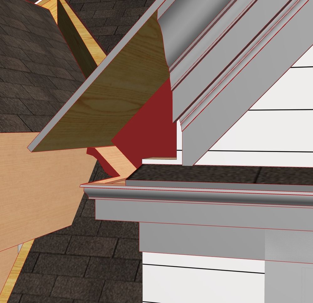

How do you go about doing this? I've gotten everything to align well, but when I try and run the angled trim at the face of the dormer down it "effs" everything up.
I'm trying very hard to "model more, draw less" but sometimes it's frustrating!

I understand the sloping piece up the rake is actually a slightly different profile.

Hello Steven,
Please see this thread. It deals with several issues
related to rake and eave moldings.
http://archicad-talk.graphisoft.com/viewtopic.php?p=103276&highlight=raking+molding#103276

The Wiki has an article showing one technique that uses the Shell tool -
http://www.archicadwiki.com/GableProfileWithShell
It would be much simpler if GS just allowed you to adjust the end angle of complex profiled beams like you can now with shells!

Your best bet (in my experience) is to model the profiled trim with a seperate profile and put it on a different layer with a different layer intersectiongroup. This will stop the elements interacting with eachother.
Be sure to set the intersectiongroup number on all your layer combination, so that all your views clean up properly.
The only way I've been able to give angled beams a proper mitred cut, is by cutting the beams with a roof (giving the roof the mitre angle).
Luckily traditional roof / gutter detailing in NL isn't ussually detailed like this. Still, I've drafted intricate things before and sometimes I ended up going back to the old Profiler addon and just create objects. At least it's easier to get the mitred joints. It still only goes in one direction though, so you can't go around the bend in one go.

Here is an example of a rake/crown miter. This was done with profiled "beams" which I ran past each other to prevent them automatically joining. I then used SEOs with slabs set at 45° to get the vertical cuts.
As others have mentioned the rake is a different profile from the crown and it is not just a simple stretch since vertical to horizontal relationships are affected differently by the rotation and the relative cut angle.
It is not possible in my experience to fake this detail in the field acceptably (I used to be a master carpenter). You need to either find or custom mill proper rake/crown pairs or use a different detail. A common practice is to have the rake die into a horizontal return of the entablature. It's not proper classical order but it looks better than trying to miter parts that don't fit.
