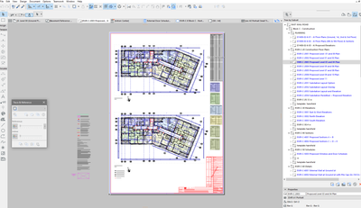

Hi All,
I am having an issue as well, with the "drawing update" when on sheets of layout book. The views update as they always did, I do NOT want to ever have to use the manual update, for many of my own reasons.
However this feels like either an Archicad 25 problem or my new PC problem, as I havent had this issue on my old inferior pc, while using Archicad 24.
The current/new PC is a Dell Precision 7920 Tower XCTO Base with
Intel(R) Xeon(R) Silver 4210R CPU @ 2.40GHz 2.39 GHz
 64GB 4x16GB DDR4 2933MHz RDIMM ECC Memory
NVIDIA Quadro RTX4000, 8GB, 3DP, VirtualLink (XX20T)
and  M.2 1TB PCIe NVMe Class 40 Solid State Drive
Please help, this is extremely irritating, every new layout i open, i need to first stand by for a couple of minutes.
You activate a Layout and you have to wait for a couple of minutes for placed Drawings to update? That sound extremely long. Those placed Drawings should update within seconds, not minutes.
Can you show one such Layout and show how a Drawing that needs so much time to update looks like placed on that Layout?
slavapolic
Hi Laszlo,
not a couple of minutes (I exaggerated, apologies), however, more than 10 seconds. I dont want to be a primadonna but even 15-20 seconds is too long if you need to be shifting through a set of layouts, am i wrong? I dont have this issue on other pc's so Im hoping its just a matter of a hidden setting as this pc is superior on paper.
What are those colorful things on the right side of the Layout? Are the schedules placed as Drawings on the Layout? If they are, I wonder if that is the cause of the slowness. Archicad probably has to regenerate the Schedules every time and then update.
If you want to investigate a little bit you can try things like:
1. Delete all Drawings that come from Schedules, and see how fast the update is.
2. Delete the Drawings that come from Floor Plans, and see how fast the update is.
That way you may find that one or the other causes most of the update time.
Also, you said that you don't have this issue on other computers. Are you saying that if you work on this exact same file on another computer with the same Archicad version, your Update times are much faster? If so, there is probably something specific to this computer that causes the slowness.
