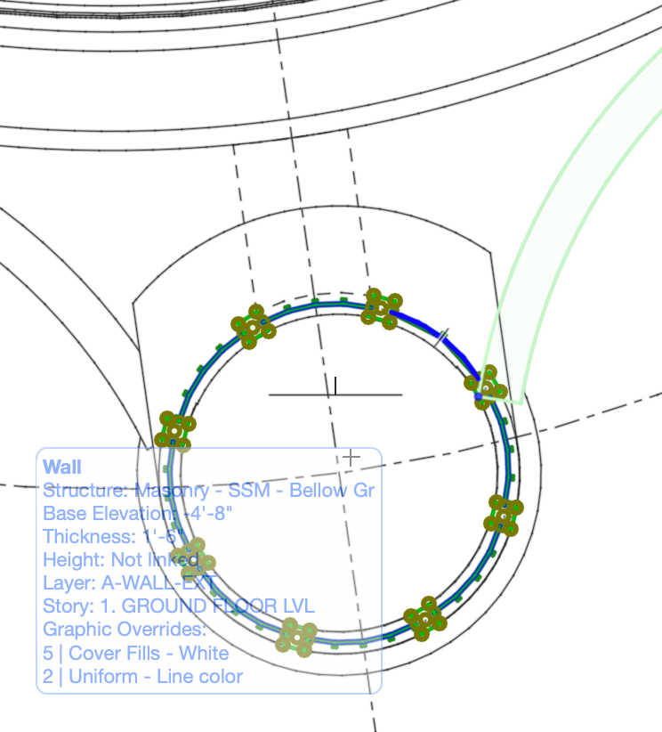

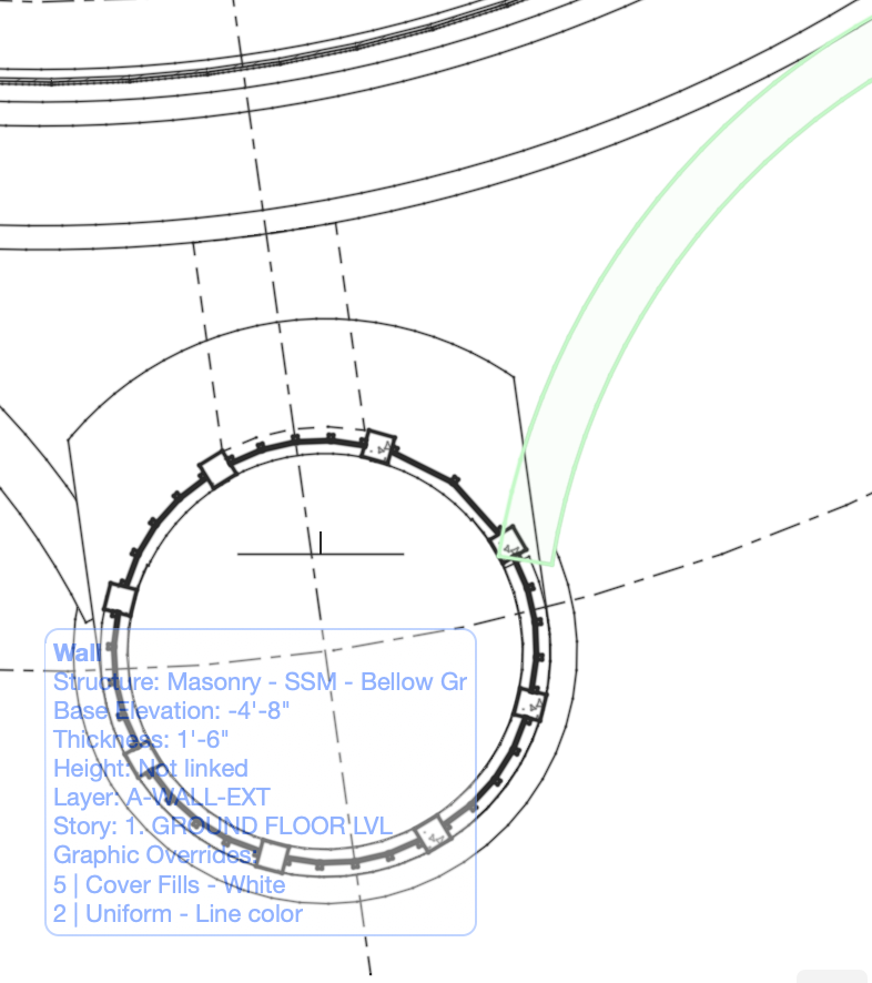

I made a block and copied, thinking the copies of the block would get modified (as in other drawing software).  But when i change an item in the block, none of the other blocks are changing.

You created a "Group" not a "Block" and groups are independent of each other. Changing one will not update the other.
What you want to use are "Modules".

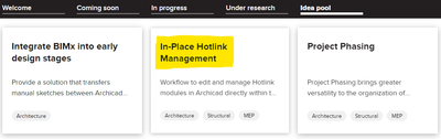

Unfortunately this kind of behaviour and 'module' (block equivalent) handling is far away from the current version of Archicad, as in-place editing is still in the "idea pool" on GS's roadmap: https://graphisoft.com/product-roadmap/idea-pool
I could imagine module editing to become something like instanced groups in Revit:
https://revitpure.com/blog/16-tips-to-master-model-groups-in-revit
