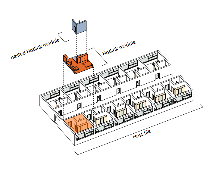

The Hotlinks allow us to insert the contents of external files (Sources) into the currently open Project (Host). Hotlink Modules can be used, for example, to manage the repetitive structures of buildings such as hotels or offices with a large number of identical rooms: if rooms are placed as a Hotlink module, you can modify all the rooms in one step, by just updating the module’s Source file. Moreover, the same Source file can be used in multiple projects.

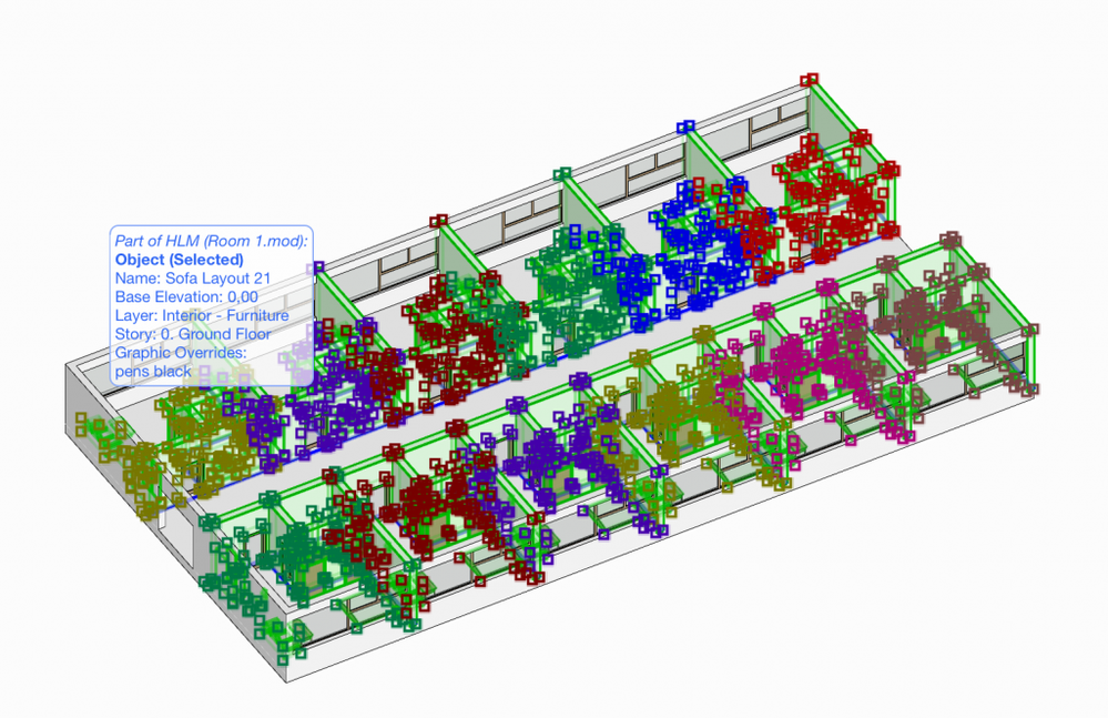

The Info Tag distinguishes selected elements belonging to a Hotlink. A selected element which is part of a Hotlink will be marked with hollow squares. If we select several Hotlinks, their selection dots will have different colors to help us distinguish them.

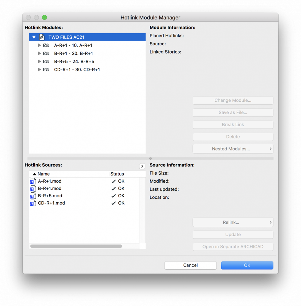

Any Hotlink placed in the Host project will be listed in the Hotlink Module Manager (File/External Content/Hotlink Module Manager). Archicad’s Hotlink Module Manager dialog provides an overview of the Hotlink’s hierarchy and a feedback on the status of the individual Source files (up-to-date, missing, modified) and their Source location.

Any file that is already a Host for Hotlinks can be used as a Source to another Host. In that case the Hotlinks in that file will become Nested Hotlinks. Simply put, it is a Hotlink inside of a Hotlink. Nested Hotlink data is embedded in theHost project. Similar to normal Hotlinks, a nested Hotlink will still be visible even if its Source file is inaccessible. We can skip placing a nested Hotlink.

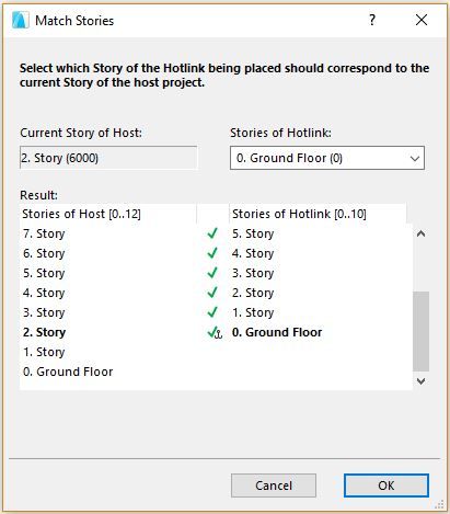

When placing a Hotlink it is possible to choose if you want to place a specific story or all the stories that are included in the Hotlink file.
In case the Host file and the Hotlink file have different number of stories and different heights you can control how the Hotlink will be placed in yourHost project and how it will adjust to its elevations.
You can choose between keeping the existing Story Structure of your Hotlink Source or adjust to the Host Project Elevation. Also you can offset the placed Hotlink. And as a final step you get to select to which of your Host Project stories you want to associate your Hotlink stories. See Story Management of Hotlink Modules
