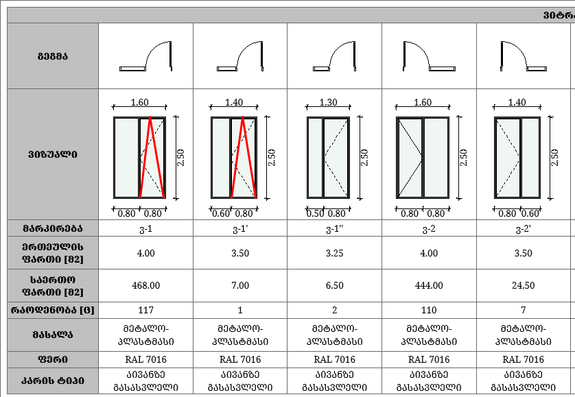

Hello. I was wondering if it's possible in ARCHICAD to create bottom hung doors. Doors in ARCHICAD library only have side hung or double acting opening types. I need to add bottom hung function in an easy way to show them in Door Schedule.
Here's an example of how I want the doors to be drawn in the schedule:

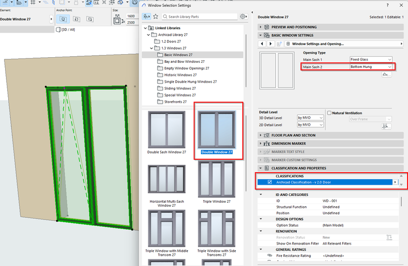

Hi @Kikoria
Maybe you could use a Double Window with a Botton Hung main sash instead. To be listed as a door just change its classification.
It is not perfect, but I hope it works for you.
Regards. -
Ricardo López, M. Arch.
Kikoria
Thanks for your reply! Yes, that's how I do it currently and that's the best alternate way. But the thing is, technically it's a door and in the floor plan it has a different representation. That's why I wanted it to be done by the Door Tool.

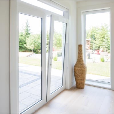

Here it is:
Kind regards,
Tamaz Kikoria
Architect
Technical Examination and Design Department
GEORGIAN WATER & POWER
Kikoria
Hey Barry. This is how they look like:
Kind regards,
Tamaz Kikoria
Architect
I see, thanks.
So it is not an opening for access, just ventilation.
Basically it is like a tilt & turn window.
So hinged doors also need a 'tilt & turn' option like the windows.
You might need to make a wish in the wishes forum for that.
There must be a lot of force on the mechanism locking it in place like that.
Especially with double or triple glazing.
