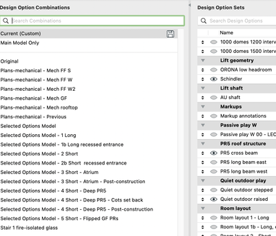

I think the problem is that I had imagined that Archicad treated what I see in the Option Status field in Classification and Properties tab of the element's settings as if asking which combination of options must be active for the element to be shown:
But I now understand that the active options in there are not really what you want the element to be linked to; they are merely what is currently active in the plan view. And even though I can enable them from inside the element's settings dialog (above), all I am doing is making them visible/invisible once I close out of the settings dialog box. Not that I am 'linking' the element to a combination of these options...
Poor interface, I think.
TL;DR It becomes clear that an element can only be linked with *ONE* option only.
Which means I have to break down every single permutation of the matrix of options, and create linear options for every single combination.
Not really helpful but it is what it is, I guess.

It works very much like layers –you assign the element to one layer only, and that layer can show in as many layer combinations as you want (you don't assign elements to more than one layer, nor to one or more layer combinations). You link layer/design option combination to views through View Settings, which are independent of whatever the screen shows (during work you can manually turn design options on and off, and the screen options/Quick Options will then show a “Custom” Design Option Combination; just as with layer combinations, normally you don't want “Custom” frozen into views, but would rather create specific Design Option Combinations).
I think the design options implementation has been pretty awesome, life-changing.
[Probably known,  just in case: it is best to have layout-etc. views showing a “Selected Options” Combination, which turns on and off the desired Design Options in the sets as needed por presentation purposes, as the design evolves. For screen or document presentation purposes you can duplicate view folders and modify only the Design Option Combination assigned to them; seconds.]
