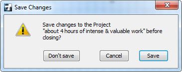

There's nothing wrong with hitting the X (Close) button, if you're talking about the one in the top right corner of the application. That's the same thing as closing the window. And if the current window is the floor plan, then it will close the project and exit the application. Unless you have just saved and done no work since, ArchiCAD will prompt you to 'Save Changes' as usual.
So did you save or did you ignore the prompt?
"...I accidentally closed a session of AC without saving..."
Unfortunately it's gone. You LOST all. When you closed AC it ERASED the entire folder named "ArchiCAD AutoSave Folder"...It contains a sub folder "@ODB_ObjectSetsxxxxxxxxxx and 3 files, one of this is your .lck file "@Global.T") . Now if you started AC again it will create an empty folder with that name in the same place.

A few more posts here since I stepped out check on my new best "friends" in the refer. Not hitting "save" instead of AND hitting "don't save", [worse than ignoring the promt], which in some zombi-like state I clicked on instead was the "......major dumb SH!_ move....." on my part and I suspect/hope/pray I won't do this again. We tend to remember the hard lessons best.
Time to go rebuild what was from memory, and indeed it should be faster the second time through.....
