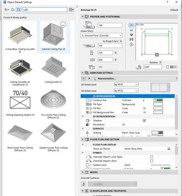

@Mats_Knutsson ,
Here is a tutorial, from which I always do ceiling based on it, and never had issues with that.
Also for all holes you have in Object tool libraries to put on ceilings - lamps, ventilations, air conditioners, holes etc.
Watch the ceiling tutorial, or maybe I didn't understand what you needed.
