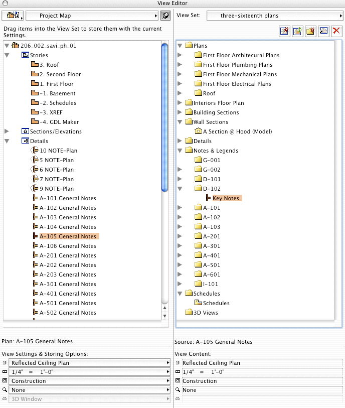

Why does the source of D101 folder remain at named folder A106?
this user can not locate "source" to change in the navigator, or elsewhere
see attached "Picture 3"

Source view aren't linked to any folder that you create and give them any name!
Source Detail Name in Project Map that you show on screenshot has a name that you wrote in "Detail Settings" Dialog. And for saved views in ViewSet you can type any custom name and then rename it and it will not replace the name of say source detail, because there names aren't linked with each other.
