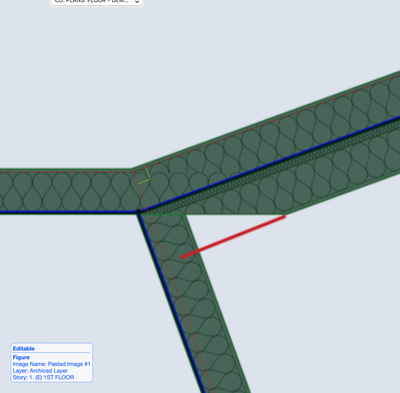

I have spot where three walls joint at one location. I want to change the joint so that the double wall continues through as indicated by the red line. How can this be done?

If all of the reference lines end at the one point, it is just adjusting the junction order value.
No need to play with different layers and intersection group numbers.

Try adjusting the junction order value of the walls.
Make the 2 that you want to join the same number and the other wall on the left a lower number.

wall connections are typically solved by a combination of:
-reference line position
-building material priority
-wall junction order
Barry has already suggested the most likely solution to fix this, the junction order. But as Ryejuan asked, are there other options... If this was my file, I would always start with reference line position. In the screen shot shared by the OP, try putting the reference line here:
Often the reference line needs to have an offset to keep walls positioned properly and joining in the correct order. Junction order by itself is never a catch all, and often results in a domino effect with junctions at the other ends of the walls being adjusted.

Keep the left and bottom wall in separate layer with different intersection group than the double wall.
This is in one of my project where walls has to join 0,90 and 45 degrees. Pasted the photos before and after enabling the reference line. As I model the interior gyp. board finish separate, I have to keep those walls' reference line away from the core with different intersection group number. Reference lines of elements with same intersection group meeting at close or same point doesn't work well all the time.

Yes, the domino affect can be a problem.
Another solution is to place a column (even a custom shaped complex profile column) at the junction.
Or there is a 'patch' tool, but that is just a 2D cover up.

I find that junctions like these never represent 100% in AC when Composites or CPs are involved... You can often play around with the Juntion Order to get it almost right, but there are often holes or overlaps in the fills. I usually connect all of the walls as in the OPs image, then copy paste them into a CP column and clean it up there. The issues become even move visible when the involved walls do not use identical Composites...
