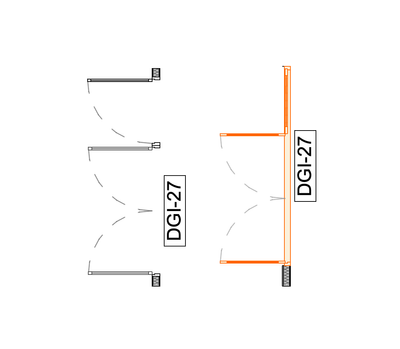

Is there any way to get the CI door to show all three leaves as open? I've gone through all the obvious settings but doesn't seem to work.
In the screenshot attached you can see two examples. One is showing the a standard double door and a seperate single door and the other is showing a CI door with 3 leaves (2 open 1 closed).
Ideally I want to show a door with 3 hinged leaves, doesn't matter if it is a standard archicad library door or CI door.

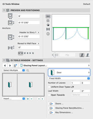

try using the c/i window tool, with the configuration/operation set to "door". Also works with the "exterior door" (which is really just the c/i window that has been tweaked from the OG c/i window library part. It's just not an option with their librar part calld CI Tools Door.
