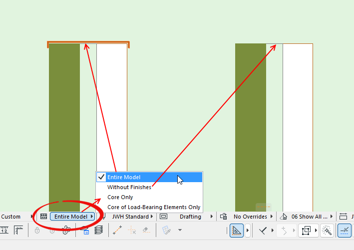

Each fill (building material) you use in the complex profile can be set as 'Core' , 'Finish' or 'Other'.
Then in any view you can choose the Partial Structure Display to show what the finish or other skins.
The core will always be visible.
Note: you have to place separate dimensions for each Partial Structure Display if you want to see different parts in different views of the same view point.
The dimensions are unique fir each Partial Structure Display.

gpowless
Best wat to achieve this is using renovation settings. Set this by selecting the flashing in profile manager and change the renovation element to "demolished". To dimension  the wall, change the renovation filter to "existing". If you need to see the flashing as in wall sections or 3d projection you simply set the renovation filter to "show all". It is important to note that if you place any construction material in a complex profile outside of the finish faces, when you use automatically dimension walls and slabs setting in your dimension settings, it will select the outermost material identified as a "finish". This is important for floor plan dimensioning in that even if the material is 1/128" (0.198mm) outside of the main wall it is nearly impossible to chase down an accumulative dimension error that will occur.
