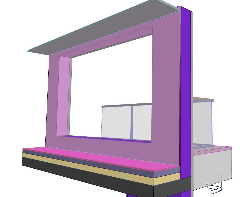

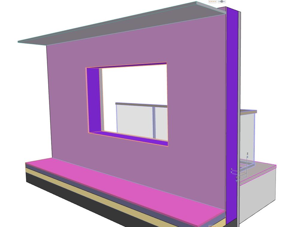

Hi, can someone help me with this please?
I made an example to "illustrate" the problem. If you look at the screenshot, there's wall 1 and wall 2. Wall 2 is hosting a window - an opening for the window is cut automatically.
Now, if I move the window into wall 1, the window does not cut wall 1.
In Revit, if 2 different walls are connected, joined or embedded into each other, the window recognizes them as 1 and automatically cuts it. Here's a screenshot of the same situation I made in Revit. What is the best solution to achieve this in Archicad?

Unless something has changed, you should not need to stretch anything, the created Opening from Selection should match the size of your opening and automatically cut the bounding walls.

If I use the"opening" tool, it just cuts a hole in the wall. But it doesn't "wrap" the internal finish skin. If you understand what I mean.
An "empty" window does wrap the skins. (See screenshots).
Oh well... Archicad has it's limitations I guess 😛
You can adjust the opening to peneteate any skins you like and change the perimeter surface to be as the external skin (Reveal), that will let you avoid error & duplication in windows schedule.
