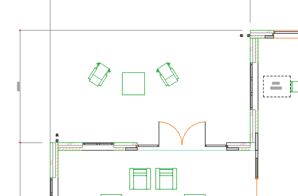

Hi, can anyone help.  I have opened a new copy of the file and notice that the walls are not connection correctly.  I am sure I have something turned on or off but can't figure it out.

Hi Joe,  It was the renovation filter.  Even though the wall in question was new as are all the other walls, when I turned off showing existing the walls joined correctly.  Thank you.

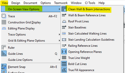

joelcowell
HI Ian,
Could be a couple of things, check if Clean wall and Beam Intersections is on in the menu bar: "View" then "On-screen View options"
The other thing it could be from looking at the screen shot is the building material priority's are off. but less likely.
hope that helps? might not be either of these but this is where i would start.

Are the Reference Lines of Walls actually touching each other? That is also a requirement.
joelcowell
Hi Ian,
Also one other thing is if you are using a renovation filter it can override wall junctions too.
Solution
