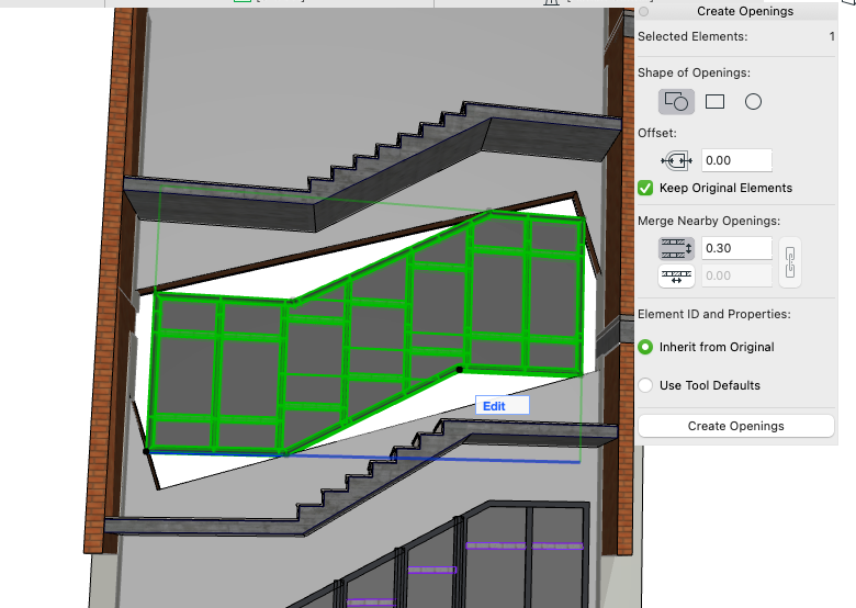

Hello,
I have created a curtain wall with a particular shape, and when I select "Create Opening From Selection" the resulting opening does not follow the shape of the Curtain Wall, but instead has a strange shape.
See attached image
Operating system used: Mac Apple Silicon 13 Ventura
Mac OSX 13.6.6 | AC 27 INT 5003 FULL
3 REPLIES 3
cuba
Probably because it was made for rectangular or circular mep shaped elements (with an offset)
It is possible to adjust the opening afterwards to fit your curtainwall.
Apple M1 Max 32 GB Ventura
AC27
It is not the shape of the object that will form the opening shape.
That can only be circular or rectangular (with that tool), or that first option I believe tries to best match (circular for a circular pipe, rectangular for a rectangular pipe).
As cuba suggested, you will have to reshape the opening after you create it.
Also the create openings tool is really for penetrating objects like pipes.
For the curtain wall like that you could just draw a polygonal opening around the frame.
Achille Pavlidis
OK got it.
It's a shame though because the shape with the rectangle and circle makes you think that it is possible to have a complex shape.
I did draw a polygonal opening around the frames, but I was hopping I could save time by automating the process... though luck I guess...
