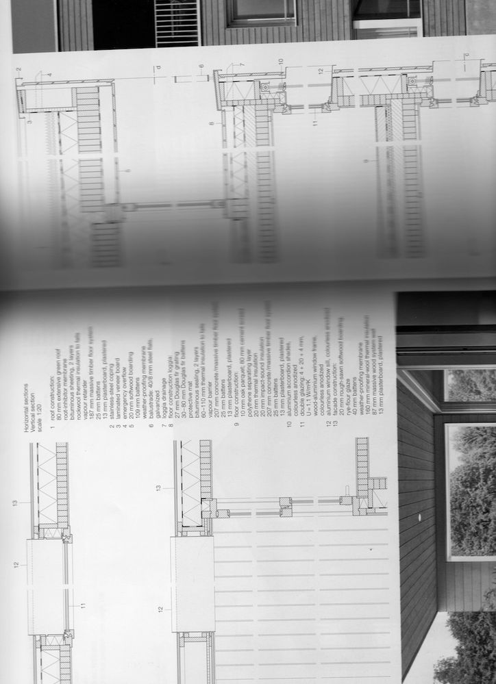

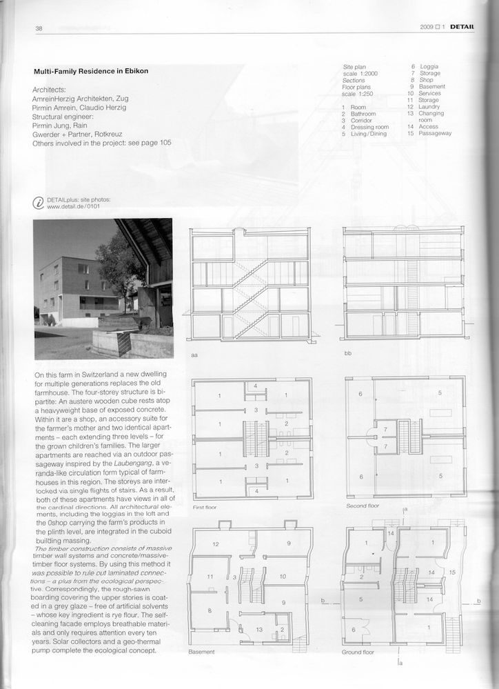

I've attached a scanned image of the type of documentation I wish to create. There are 2 types of section shown, an outline section and a detailed section. If I created the 3D model using no fills, I could then have sections with no fills, thus creating a outline section. I could then ' zoom' in on parts of the sections to show construction details at a larger scale obviously. Should I create the construction details i.e a larger scale section by manually adding fills ?
I'm not sure if it's easy to tell, but how could have the below images have been created, by the most simplest way !
Again, I apologise if I'm just re-typing what you say but I want to get it right from a professional point of view, not just looking at documents found in a magazine.
Thank You very much for your help.

You chould create a view for each drawing you will be creating. With each view is saved the scale, layer combination, model view option, zoom, etc.
In your examples your building sections will most likely be at the same scale as your floor plan. You may have a wall sections that are saved at 2-3 times larger. These, like details, you will add in the 2D (annotation) information. Annotation includes fills, library part symbols, text, dimensions etc.
Notes and symbols legends e.g. lighting legend can be in your template on independent worksheets.
Details can be started right off the model (how you place your detail marker) and saved at whichever scale and other view setting options will be appropriate for that drawings.
These various drawings, the building section, wall section, detail, sheet notes, legends etc are all arranged on the layout sheet.

I see, so when I create the 3D model, should I set up as many fills/composites as I can or should I have them all empty and add any fills I want using the fill tool in layout?
The easiest way to start is to keep the fills to a minimum and fill in the details in the enlarged drawings. As you get to know the program you may want to enable more automated drafting from the model, but some inherent limitations to this have kept many advanced users from this approach.
