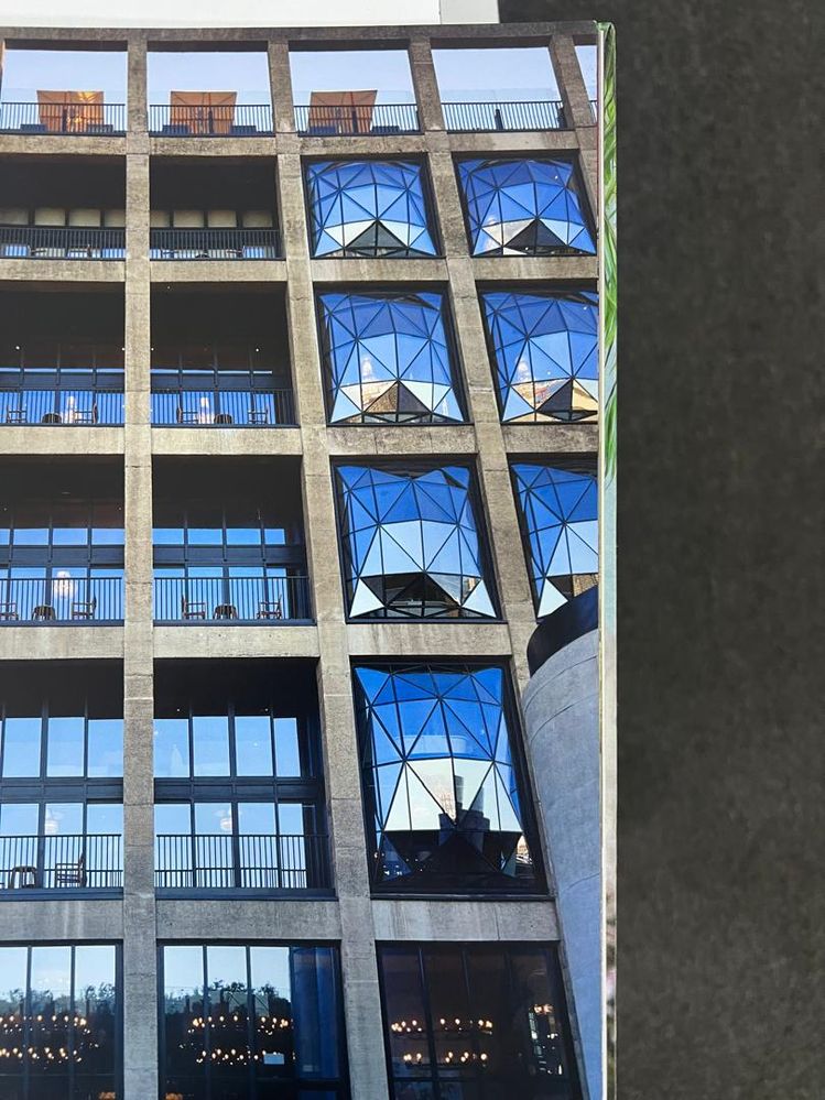

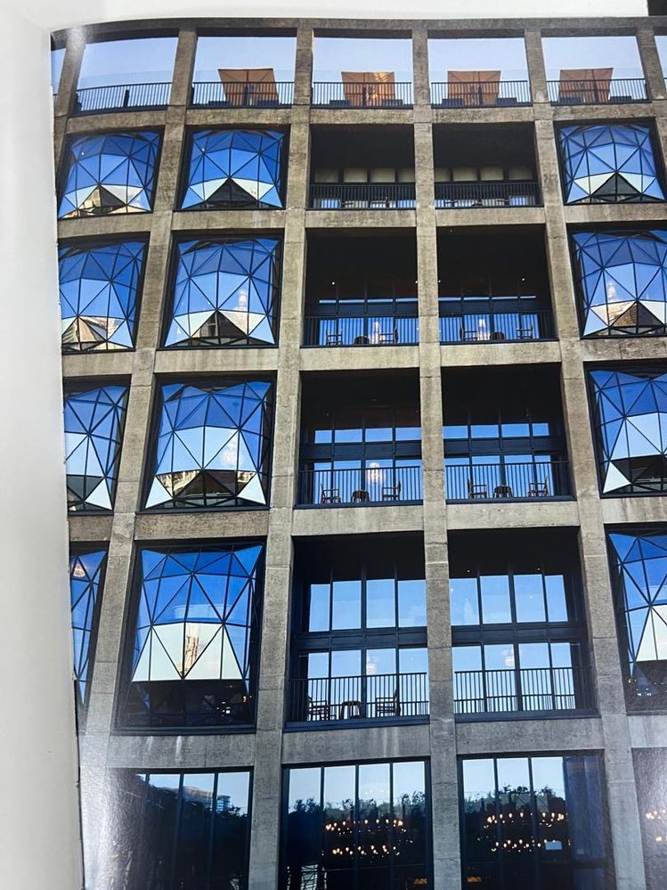

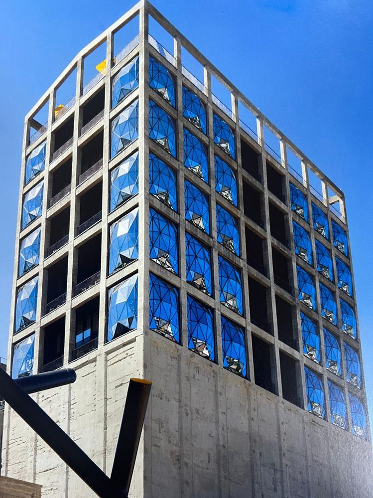

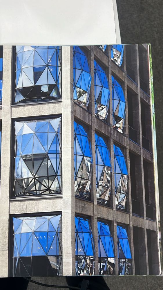

I was asking how to achieve the swollen curtain wall as shown in the photo attached

I think a custom window panel would do it. I don't see this as a CW.

I guess since they are identical, that could work. Just need to model 1, maybe 2 if the sides are a different width. Make use of the 3 point placement for single-plane roofs!

This is 5 min effort. Custom window (ugly byt hey...). It could be a custom CW panel as well.
