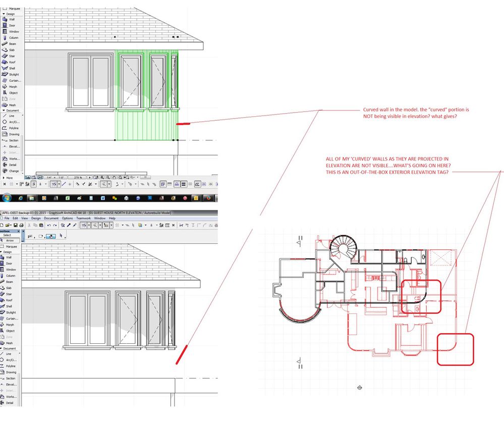

I have quite a few curved walls in this model.
I've placed an "out of the box" exterior elevation and the "edge" of the curved wall is NOT showing....what gives folks?

It seems to happen when the edge of the window opening is placed exactly on the end of the curved wall.
Sorry I don't have a solution except to move the window slightly away from the end of the curved wall.
Oddly enough though when I move it back to the end the wall remains visible - so maybe that is the solution.
Place it, move it then move it back.

Select the window in plan and drag it away from the end of the curved wall.
This only needs to be a small move in my experiment.
Now look at the elevation and the wall should be OK - it was for me.
Try moving the window back in plan to where it was before - my wall remained OK in elevation after I had done this.

Arghhhh!!!!....no no no....no 2D!.....model "MUST" work!.
geez...I despise doing that. drawing 2D stuff when the model should just "WORK".....
I tried the window movement around.
didn't do if for me.
as a matter of fact, when I copy the 'curved wall over to the left 10 feet and just look at the elevation of the curved wall...same thing....it does'nt show the edge...dunno.
this blows.

seriously.....I have no idea what causes this?
it has something to do with the the wall cleanups?
dunno...cause when I copy these walls over and do a "fillet with radius of 4'0") it wont show the edge, with or without windows, doors, whatevers....still blows.

I mean..here's the test.
take two walls at 90 degrees from each other.
Don't make them touch just yet.
separate the walls by say....10'
so you should have an "OPEN" L-shaped diagram in plan.
then use the "chamfer" corner command and use the "radius" instead of the "chamfer" at about 5 feet.
then look at the elevation. Seems the "chamfer" and the walls do something where the "edge" becomes invisible....it's a glitch.

Chamfered walls work fine for me until I put a window in exactly at the end of the curved wall.
rob2218
huh....well...dunno sir.
dunno if it's a composite issue, a wall issue, a real live glitch issue...just dunno.
allz I know is that it doesn't produce an "edge" line when viewing the wall in elevation.
