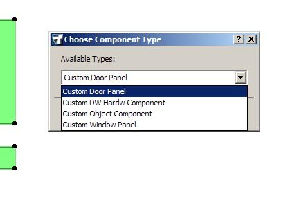

Does anyone knows how to use this option (see the image) on the curtain walls?
-how to create the profile, how to save it where to save it?
Thanks in advance for your help.

I can't see CW frame, panel or cap option in the dropdown menu ... am I doing something wrong?
Which version of ArchiCAD are you using?
Curtain Wall is available in AC12 and later.
2x28" (2560x1440), Windows 10 PRO ENG, Ac20-Ac27
Using ArchiCAD 12 with latest updates.
What Library do you have loaded?
Is it the default AC12 Library or something else?
Does it work if you load the default ArchiCAD 12 Library?
Ah, yes. It was a library issue. I had version 11 and version 9 loaded.
