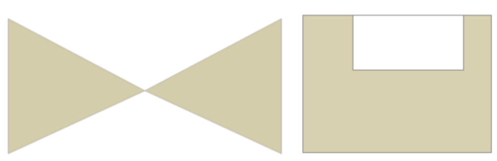

Self-intersecting polygons
Reason
There is a big chance that a self-cutting polygon is the reason behind the error message, when the shape is twisted and has less hotspots than corners.
Solution
Recreate the element or the profile from two or more individual parts. - In this case, from two triangles: both should have three hotspots.

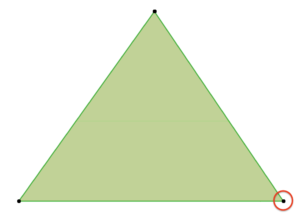

Two points of the polygon are overlapping each other
Reason
When a polygon has more corners than sides, two corners are covering each other. For example this is a triangle with four hotspots. The duplicated corner is marked with the circle.
Solution
The difference between a simple polygon and one with duplicated corners is invisible, so after After finding the problematic element with its ID, it should be deleted and created again.

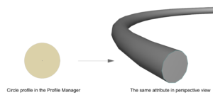

Arc in profiles #1
Reason
In ARCHICAD, curved faces are modeled with polygons. This why all the arcs - created in the Profile Manager - are converted to short straight lines. When these lines intersect each other, the profile is gone to pieces. When the 3D engine can't count this conversion properly, degenerated polygons are created.
Solution
Don't create profiles from arcs and curved lines. In the Profile Manager, always use straight lines.

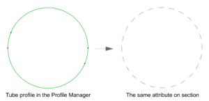

Arc in profiles #2
Reason
When the arcs of the profile aren't converted well to straight lines, degenerated polygons can be created in the 3D view. Curved elements - using this kind on profiles - can be corrupted easily.
Solution
Try to use straight lines and less segments in the Profile Manager, especially when using these attributes with curved elements.

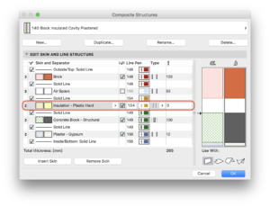

Zero value in Composite Structures
Reason
Composite Structure layers with zero thickness cannot be visible, ARCHICAD does not represent them. This inconsistency can cause degenerated polygons as well.
Solution
Do not use zero value in the Composite Structures, every layers should always have thickness. - Modify the invalid value to a positive number.
