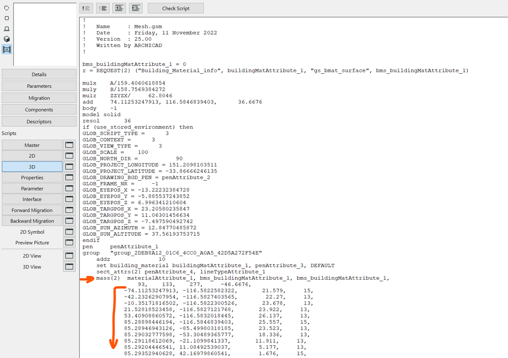

@Barry Kelly, is there a way to export coordinates of all mesh points as xyz?
If this is not a too big of a mesh, you can place a 3D coordinate object on each node and schedule out their coordinates. You could review them in a spreadsheet and then import back to Archicad as "place mesh from surveyors data".
gotphish
I'll need to check those issue nodes coordinates. I'll turn up the precision to see if they are off by some amount I'm not seeing.
Nick DiPietro
Cad Manager/Monkey
Autodesk Expert Elite
Archicad 29 Solo USA
https://farkasassociates.com/
Actually you can get coordinates if you save the mesh as an object. Didn't think of this before.
It would require looking into the gdl code to get them though.
1. Select the mesh and go to File -> Libraries and Objects -> Save selection as -> Object
2. Ok on the Attributes window and any other popup.
3. Select object tool and place the newly created object
4. Select the object
5. File -> Libraries and Objects -> Open object
6. Go to Scripts section on the left navigation and open "3D"
7. Mesh should be converted into "mass". In my case it was "mass{2}"
Skip the next line under the mass as those are still mass command parameters
Coordinates of the top of your mesh should start from the next line in the format
x,  y,  z,  status code
Coordinates with -1 status code I believe are the non boundary points of the mesh.
I am on windows so I would grab them and paste to notepad and save as csv or text. You can then open this in excel as comma separated values.
I would add a numbered index as an additional column in the spreadsheet if you are going to be sorting them so you can revert to original sorting order.
