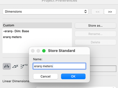

why is it necessary to keep renaming a "store as" under project preferences for dimensions to an existing name only to "store as" under the same name. is there a solution to what seems such a simple idea of overwriting the selected preference.

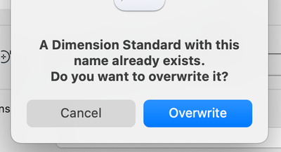

The 25+ year workaround is.
  • Before editing the Dim settings copy the name by using rename and then cancel.
  • Edit the settings as you need
  • At the "store as" prompt paste the name
  • When you select "OK" you will get this "hidden" dialog
