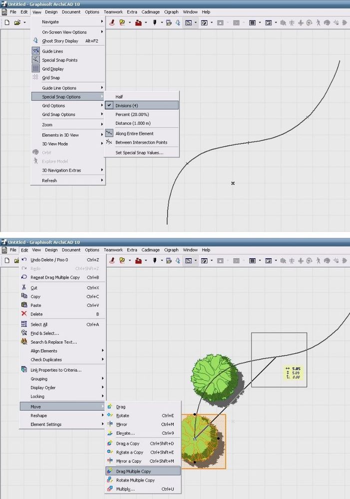

Can you distribute something along a curved line in ArchiCAD????

Yes you can... But you don't have a single procedure to do that...
Here is what I would do:
1. Define the snap options
2. Drag MultipleCopy
