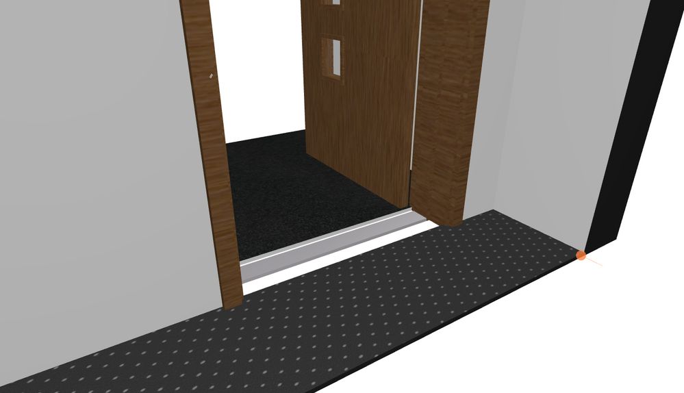

Let me first explain how this project is set up;
Finished floor level is set at '0'. Slabs of 15mm thickness are used to create various floor coverings such as wood, carpet etc. In 2D 'cover fills' generate our floor finishes drawing, and in 3D we get an accurate visual representation of floor finishes from room to room using this method.
Another slab is used for an entire floor area to indicate a structural slab in section. The top of the structural slab is set at -15mm.
The walls are set at -15mm up to ceiling height. This however means that when you place a door, I get this problem of not being able to 'see' my floor coverings meeting in the doorway. Why?
Lifting the door up to +15mm means I can see wall. Am I meant to be using this combination of elements in a different way to eliminate this problem?
This is in AC18. Thanks in advance.

Second picture without floor covering selected.

I don't have access to my AC just now. Just a thought can you modify the threshold element of the door component and match your finishes? It may require the door opening size to be increased, which could affect schedules. Can be a catch-22 some of these problems.
Other option if door dimensions are critical would be to create a threshold slab and SEO subtract it from the wall.

I cannot tell from your screen shots: does the floor coverings Slab go into the door opening, under the Wall, or stop at the face of Wall. Also check the Building Material's Intersection Priority of the Wall and floor coverings Slab, the Wall may be cutting the Slab.

Try to increase the Intersection Priority number of the Building Material of the Floor Covering Slab so it is stronger than that of the Wall. Right now Wall skins are stronger than that at the threshold, this is why you see that and not the Slab.

Why not have the Structural slab at 0 elevation, with the base of walls at 0, and thin finishes slabs above that? Undercut doors by 20mm and take finishes into openings, as it would be done in reality.
