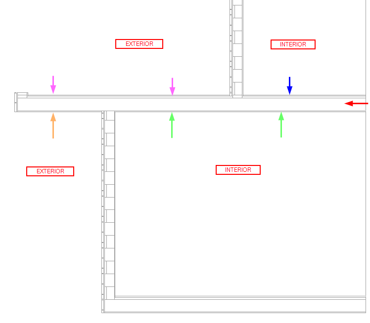

dan_g wrote:Hello everyone.
Otherwise how do you deal with changes in covering from room to room? Answer: You have a tonne of fragmented structural elements. Confusing if your looking to BIM/IFC the project outside of your office.
I have to agree with alemanda and Dan on this one. This is why AC and GS should make parametric sketching one of the top priorities. It was recently mentioned somewhere else the wish for per-skin editing, as issues that arise with composites are getting more common these days as models get more complex and detailed.
In the most simple scenario, in a house with concrete structure (slabs), you may have several finishes on top (let's assume two: inside floor and outside terrace floor) and two finishes on bottom side (inside and outside). Depending on the combination of spaces across stories, one would need several composites to accommodate for the possibilities, and the need for several structure (concrete slabs) elements is a must; like noticed, it creates confusion as to why have 3 or 4 structural elements defining the one-and-the-same slab (just because of the finishes?!?).
Parametric relationships between elements would solve this easily and in some cases would render the partial structure display useless (using layer combos, although the simplicity of it would be lost). Make one concrete slab and based on its boundaries define top finishes and bottom finishes (priority based), independent -but linked at the same time- to the structural core.
As for doors and windows in multiple parallel walls... well... the objects' (and the whole modelling paradigm for that matter) would need to be redefined to simple solids and voids; in the sense that any door represents a void that would extend from the inside plane of the interior wall to the outside plane of the exterior finish wall.
Oh... i just dream.
Best regards.

2014-07-02 01:20 AM
uisanata wrote:You're probably missing the point.sinceV6 wrote:You're funny.
Why have 3 or 4 slabs defining the one-and-the-same object, when you can have just one?
Please share a solution using a single composite that accommodates different finishes and levels grouped by arrow color in attached section scheme; so that the core/slab is only one...
maybe I'm missing something.
I apologize if I misunderstood what others are saying regarding composites and multiple elements.
