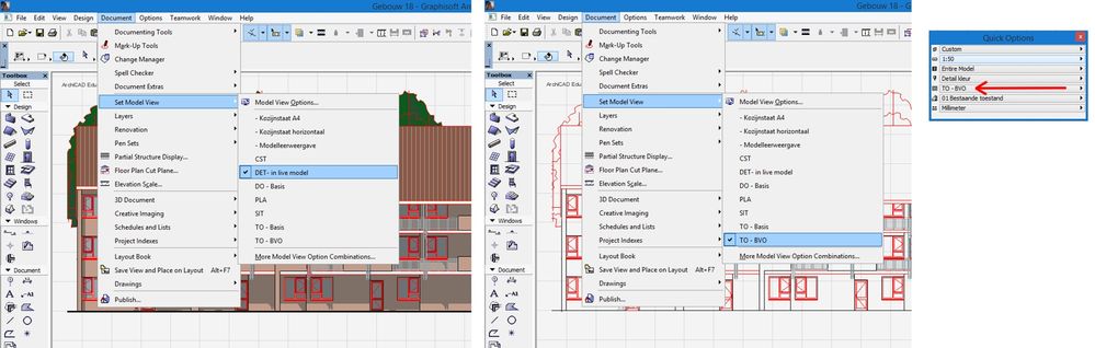

I think you must set your 'model view options'.
You can also set it at 'Quick Options'.

Steve Jepson
or here ?
Thank you so so much! My elevation view problem was solved by you. However, doors and windows in the floor plan still does not appear. Do you have any information about this problem? Thank you again...

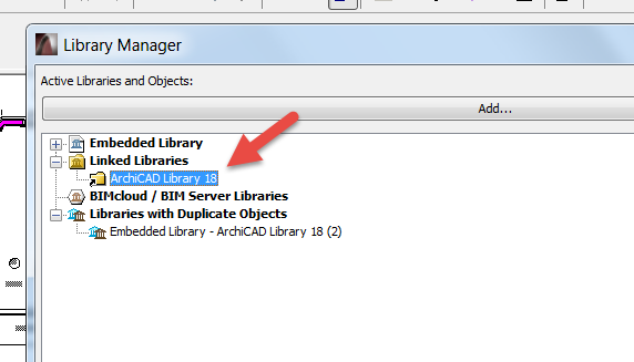

Steve Jepson
could be missing library or library needs to be reloaded. ?
