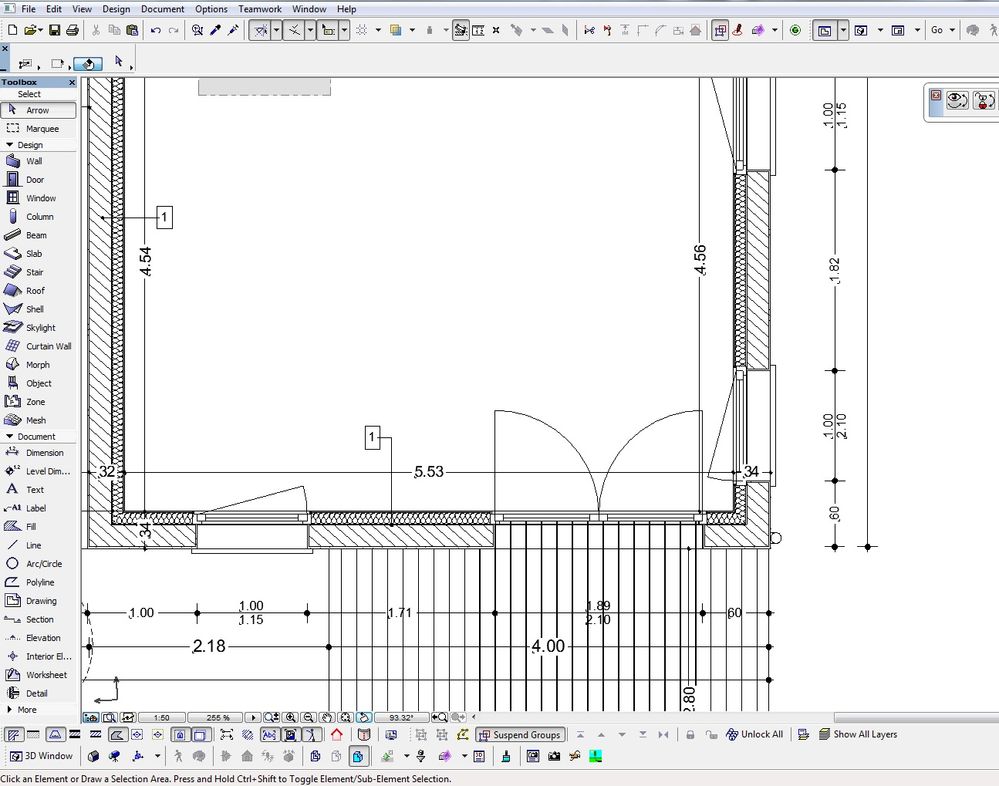

I have a problem with fill orientation when working with composites. I am working on a small scale suburban developments, and I have more than one objects that are not all aligned with project origin. I am using composites for walls that have masonry fill (45 degrees to project origin). On layouts I have to show both large scale floor plan and small scale (every object separately with its entrance facing "down"). When rotating orientation, fills remain oriented to project origin (screenshot), and I want them to be oriented to my relative view. You can see in the left corner problem wall. Fill orientation in building material dialog doesn't do the job

That option is indeed located on the same place as in AC19.But,as I said in my earlier post,none of the Fill Orientation options in Building Material don't do the job. Element orientation fill doesn't do the job for me because masonry fill on intersecting walls isn't aligned to one another.I need masonry fill orientation to be user orientated,not project orientated because I have a problem when I save my view and place it on layout.You can see on screenshot 1 how it shouldn't look and on screenshot 2 how it should.

I really don't know if there is a way to make the fill in a composite user oriented, but what I will do is (if possible), I'll do a new fill with the orientation needed and duplicate the brick material, one with the regular fill and one with the rotated fill, and then duplicate the composite and use the brick material with the rotated fill and apply that composite to the rotated walls.
