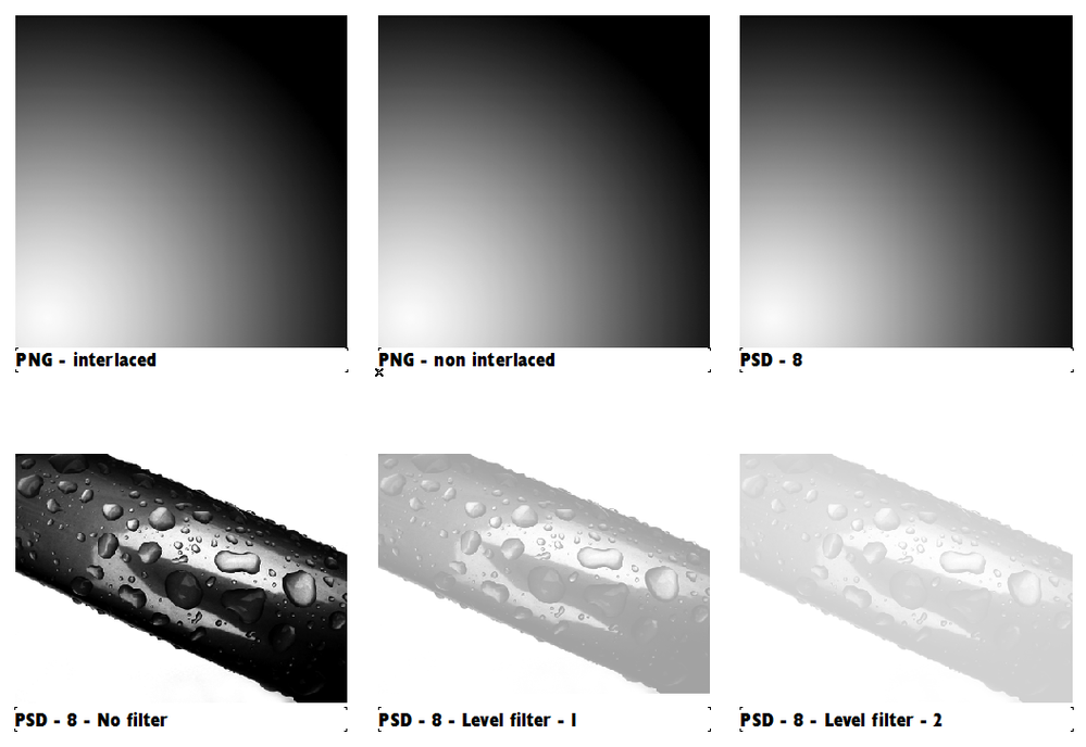

Hi Djordje,
I tried what you suggested. In fact I made several tests, based on "interesting" file type, such as TIFF, PNG and Photoshop :
when using a 300 × 300 image grayscale image, there is absolutely no problem with each format (see the attached imaged)
You can even use directly photoshop file, including dynamic filters (instead of applying the level filter to the image, a filter layer is created leaving the original image unaltered) : this is the to go, but I can't get it work on a 25.000 × 12.000 pixels image.
Is this a known bug ?
