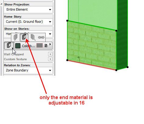

My issue is that when I try to change the material like shown above in other suggestions, it is greyed out and non-selectable. I tried several different ways but it always shows brick, and I cant change it anywhere.
Is that a bug? like my file has something wrong with it, or I made the profile wrong or is it something that can be fixed?
Only the end surface of a complex profile wall is editable in 16.
The other surfaces must be edited in the Profile Editor.
Is this end surface greyed out for you as well?

I am on 17. It just seems like that if I make a complex profile, bottom stone, a stone cap and then brick on top it would clean up per material on the elevations. I just get the default brick shown.
I am lost on the "little walls" idea. It shows where I could change it if need be but it is greyed out. Oh well, I am just going to make separate walls that clean up correctly.
Thanks for the help though.
I did contact a friend and they changed it for me with no problems, but I don't have the option to change it. Not sure why he could and I can't.
Those surface buttons work differently in AC17 than in previous versions.
In AC17 there is an Override activating button to the left of each long Surface button. This is because the Surfaces of Wall skins come from the Building Materials. If you activate the Override for any of the sides (outside, inside, edge) you can define an override for that surface.
In AC16 and before these long buttons were always enabled so there was no need to activate an override button.
In the Construction Elements page of the Project Preferences Dialog, you can use the "Use legacy intersection methods for model elements" checkbox to switch between how elements intersect. If the checkbox is turned off, those overrider buttons have a role, if it is checked, they do not.
So I think the state of this checkbox was different for you and your collegue.
