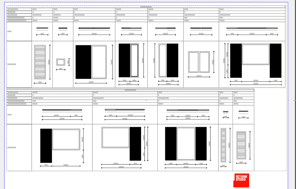

nitizz
using AC 16 since 2 weeks
upgrade from AC15 to AC16
everything works well just getting a little problem on the preview layout
see some black spot on my window schedule layout
but it looks ok on my window schedules list
even for door schedules it is the same
Can anyone help me please
here the attached file
AC27 INT FULL
27-inch 2019 iMac Retina 5K 10.14.6 macOS Mojave
3.6 GHz Core I9 Radeon Pro 580X 8GB
www.rethinkstudio.mu
My first thought is that you may want to check your Model View Options where you can control the various Fill Overrides. Maybe one of them is causing this behavior.
