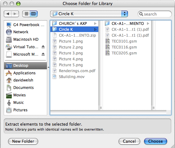

then I choose a file, to extract elements to that folder
the scale of the dwg file is lost, why this happens?, is the file bad, or my procedure?
