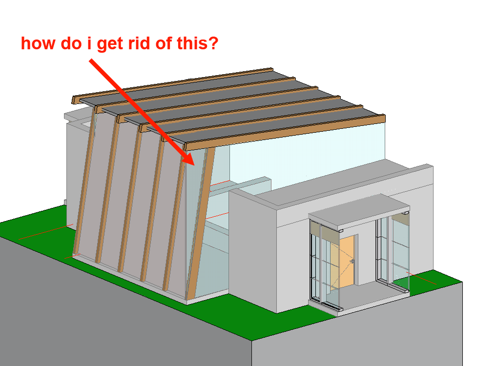

Please see attached image. How would you do it?

Achille wrote:Hi Achille,
I want to eliminate the triangular part that is exceeding of the column. But i cant find the way to do it
Have you tried increasing the priority of the beam (or increasing the intersection group number of its layer) ?
Hope that helps,
Adrian Tudoreanu
P.S.: Just to be sure: you are using subtraction with upwards extrusion; operator - the beam; target - the wall.

Problem solved!
Thanks, Adrian!
