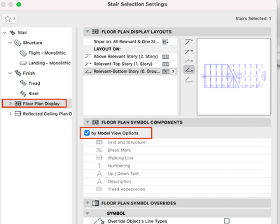

I have 2 identical stairs in a plan.
I would like to hide one stair without creating a separate layer for it, but still show the other stair.
What would be the best way to do this?

Hey @Johann_P ,
For what I know, Renovation filter yes, you can create more, but Renovation status not. There are only 3: Existing/To be demolished/New. That might be limiting for what you want to do with the visibility of stairs.
What might get you where you want (but I am not entirely sure you can hide everything) is that on the stair setting level, you can select for a stair whether the Floor Plan display is defined by MVO or in the Stair Selection Setting, and set different settings for one of the stairs.
