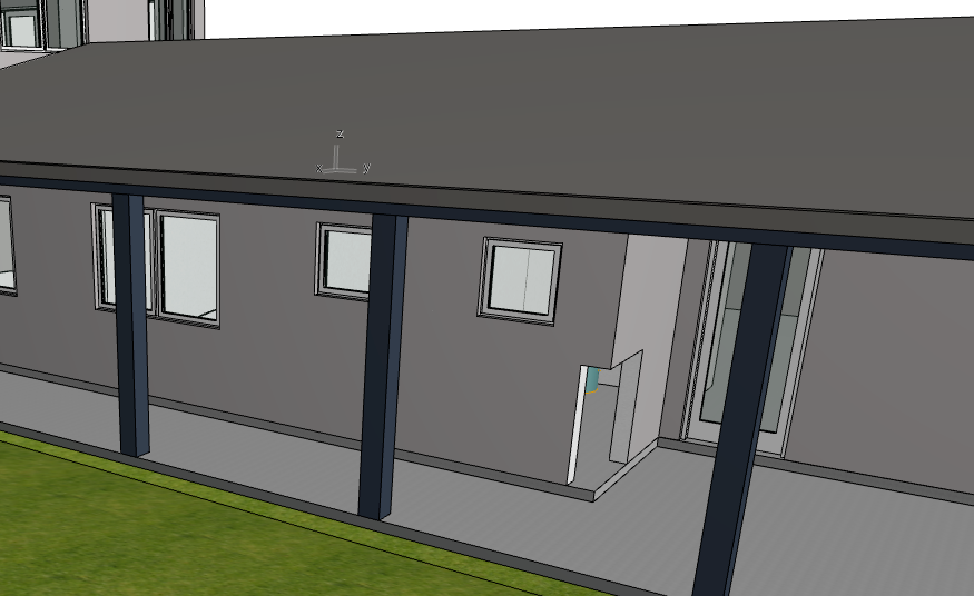

Hi, I have had to move my site back 2400mm to change the setbacks, now I have this hole in my wall as shown. Even if I delete the walls and put in new ones the hole remains. Any advice appreciated.

Turn on all your layers.
You will find there is another wall, beam or slab with a stronger Building Material in the way.
Delete it or make the strength weaker or change the layer index number so the two layers are different and they will not trim each other.
Thank you Barry, got it.
