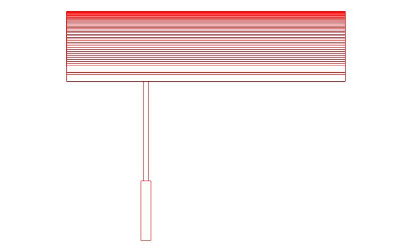

i have created a vault roof using the roof tool but i cant seem give it an angle that would make it a inclined roof. i am trying create a vaulted roof that pitches downward.
i have attached a side elevation for more clarity?????????"

You might try capturing the section profile of that roof (or draw it from scratch) and use it to define a custom profile for the Beam tool. Draw a 'beam' and set the angle to the incline you wish for your roof.

Look here:
http://archicad-talk.graphisoft.com/viewtopic.php?p=106115#106115
