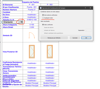

how can the door be separated? can it be put together? i want to make a schedule door perfectly but instead it is a duplicate just because the door is opened in a different direction. do you know how to put it together or delete one of the schedule doors?

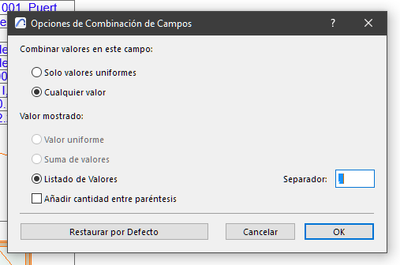

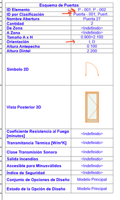

Select the fields you want to combine and tell the schedule to merge any value and list them in the same cell, for example:

If door orientation is not important you could just remove the door orientation list criteria.
