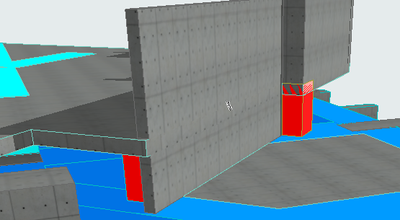

How do walls take precedence over slabs, even though they are of the same material?
In the same material, the slab took precedence, and the cognitive wall was pierced. Is there a method where the wall takes precedence even though it's the same material?
Is it just a way to draw the slab into the wall?
2. I would like to know how to make the wall take precedence in the case of walls and beams when they are of the same material.
By adjusting the color in GOC, walls, beams, slabs, etc. are expressed.
AC27 on window 11
1 Reply 1

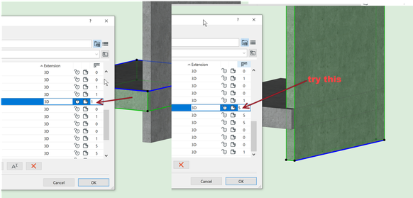

Steve Jepson
It's probably your Layer Intersect Number ?
