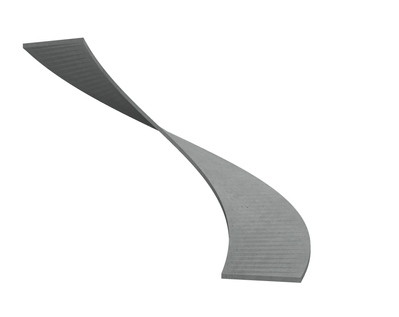

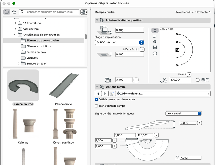

Try the curved ramp object in the library... That should do the trick.

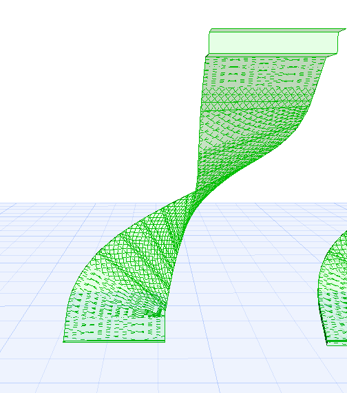

Draw a beam in the plane.
Wider than high rectangular section.
Transform into morph.
Move up and down the extremities to get your favourite geometry.
