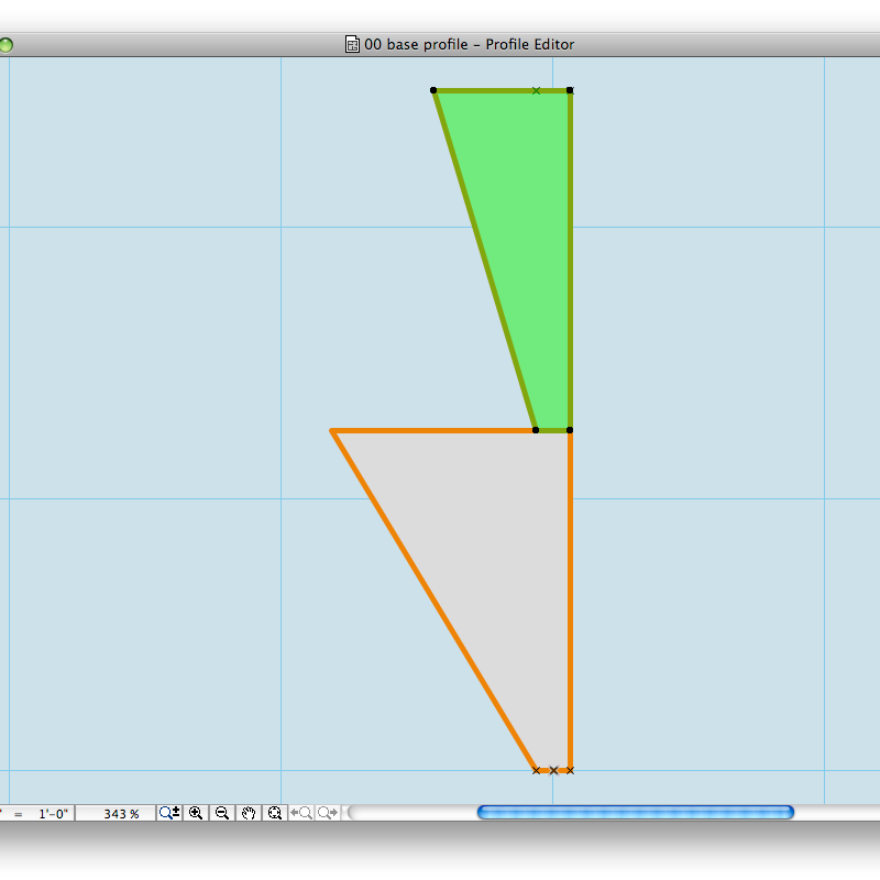

On another note I have found another strange behavior with Complex Profiles and it works on both platforms.
Steps;
1. Capture a Profile
2. Edit the profile
3. Split the profile to assign different materials i.e., yellow paint on the base and red on top.
4. Click store profile keeping the fill settings as they were.
5. Watch as AC auto heals the fill consolidating the 2 separate fills.
6. in order to edit the materials again you will have to split the fill and reassign.

Eduardo Rolon
step 03
Eduardo Rolón AIA NCARB
AC29 US/INT -> AC08
another Moderator
Eduardo Rolon
Step 04 and 05
AC29 US/INT -> AC08
another Moderator
Eduardo Rolon
Feature or Bug?
You can still apply the profile to the object and it will apply the 2 materials without problems. The obvious workaround is to have 2 different fills but if it is a concrete wall with 2 different colors then the section will not look correct.

TomWaltz wrote:
Another workaround would be to offset the edge by 1/128" to create a jog there
This should never be done IMHO This creates additional polygons.
Identical fills which touch will heal. The key is not to avoid touching...which would introduce more polygons and slow down the model... but to use different fills.
Eduardo, the behavior you have seen is normal AFAIK. After you split, you must assign a different fill to each piece. This is the same concept as wall-healing (e.g.). You may need to duplicate a fill so that it has the same appearance, but a different name (and index number).
Using this 'fill' technique, if you want a wood sill plate to have an 'X' through it, you split it into 4 parts diagonally and use two fills - one assigned to each opposite fill. A 'wall' or 'beam' created from the result will have only 6 polygons as it should. If you use the 'trick' of separating things by some tiny distance - which is harder to model anyway - then the result would have 20 polygons.

Eduardo Rolon
Another draw it as it is built misunderstood, My logic was that it is a concrete wall with different finishes and changing the material would have changed the ID for the purpose of the CP.
The correct procedure would have been that different finishes are different fills than the concrete core.
Maybe I was just surprised that the Fills fixed themselves.
